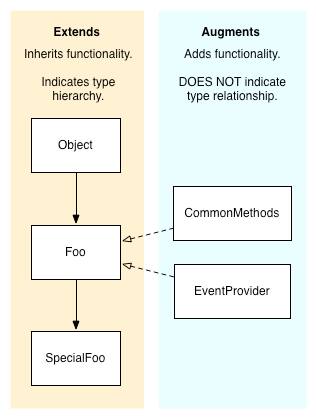

If Foo
were a part of a class hierarchy, it would be improper to include EventProvider
in the inheritance chain, since the purpose of the two are fundamentally different.
Unlike extend
ed classes, the relationship between a class and the classes augmenting it is not an indication of type hierarchy. The intent of augmentProto
is to aid in extracting nonessential behaviors or behaviors shared by many classes, allowing for a composition-style class architecture.
This may appear similar to multiple inheritance, but it's not. augmentProto
simply adds the public methods and members from one class prototype to another class prototype. Instances of the augmented class will not pass instanceof
tests for the class(es) which augmented it.
